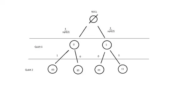

I've been learning about quantum computing, and I noticed that another way to describe the state vector is as a path in a binary tree where each level of tree represents another qubit, each node represents a state, and the edge weights represent the probability amplitude of moving from one state to another. Here's an example: (Sorry for MS Paint!)
Binary Tree State Vector
Now what's interesting is that if you start with a state vector of |0>, placing qubits into superposition opens paths in the tree, while entanglement and "measurement" close paths. I was working this out with the sudoku example in the qiskit textbook at Qiskit Grover's Algorithm Example, and I found that if you adhere to the following principles, you can find the solution state while avoiding false paths in the tree just by following the quantum circuit:

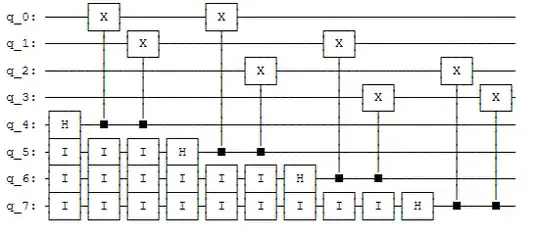

So, the circuit design would look like this (forget about the diffuser and toffoli for the moment):

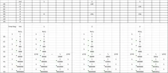

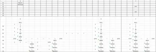

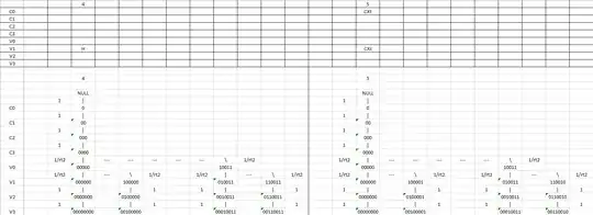

I did a step-by-step implementation of this in excel, drawing out all of the trees, and I found that only two main sub-trees form (one for each solution) and that at most only four sub-trees/branches are present at any one time. Furthermore, at the end, all of the clause bits were in the state 1. Now considering that there are a total of 8 qubits in this system, a total of 256 different paths are possible. Is this just a trivial example or could this actually be implemented as a viable algorithm for path finding?
