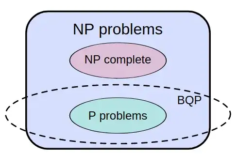

The quantum complexity class BQP is the class of decision problems solvable by a quantum computer in polynomial time (with an error probability of at most 1/3 in all cases). The relationship between BQP and the classical complexity classes P and NP-Complete is currently an open problem, but most experts think that quantum computers cannot solve NP-Complete problems in polynomial time:
This is an excerpt from this Wikipedia article:
It is suspected that NP $ \nsubseteq $ BQP; that is, it is believed that there are efficiently checkable problems that are not efficiently solvable by a quantum computer. As a direct consequence of this belief, it is also suspected that BQP is disjoint from the class of NP-complete problems (if an NP-complete problem were in BQP, then it would follow from NP-hardness that all problems in NP are in BQP).
Therefore quantum comptuers are unlikely to be able to solve an $n^2 \times n^2$ Sudoku puzzle in polynomial time. It is quite possible that quantum computers will have to pay $\mathcal{O}(2^n)$ to solve the puzzle, as would be the case for classical computers, however this doesn't rule out the possibility that the quantum computer could beat the classical computer by having a smaller constant hidden under the big O, or by having a smaller pre-factor in the exponent.
