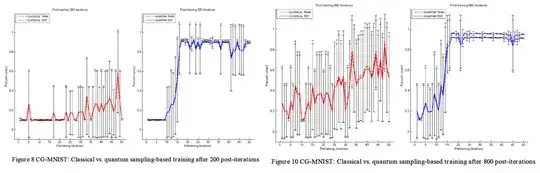

If there is any quantum advantage, this Lockheed Martin paper must show a clue.
In this paper, they utilized the D-Wave machine to sample the Boltzmann distribution and thus trained a deep neural network. According to their observation, their machine can sample far better than a classical computer at the same sampling times(I have not read their code for the classical method, so this statement might have some problem). But the author also committed that they have not provided any theoretical analysis. I myself is also trying to figure out that, or in a more rigorous way, if there are any quantum advantage.
Here is two of their plot.
Yitian Wang
