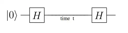

My question is about the relative phase $\varphi = e^{-i \frac{E_1 - E_0}{\hbar} t}$. This $\phi$ acts as a phase gate and changes the quantum state. Is this relative phase important and how in real quantum computers we should deal with it? One problem that I see is the following circuit:
After the measurement, the state should be $\left| 0 \right\rangle$, because $HH = I$. But If $t$ is such that the $\varphi = \pi$ then we will measure $\left| 1 \right\rangle$. We can forget about it if $\varphi(t) << \pi$ in the whole computational time. Otherwise, we should make sure that the time between gates should be $2\pi$.

The could be a problem, but it depends on how you're realising your qubits. Some realisations are configured so that $E_0=E_1$, and then there's no problem.
There is (at least from the theoretical perspective) a simple fix: if you're supposed to be waiting a time $t$, then, instead:
  • wait time $t/2$
  • apply bit flip
  • wait time $t/2$
  • apply bit flip.
This exchanges the roles of 0 and 1 for half the time so that they end up with equal phases.
Alternatively, you just take this into account and apply compensating phase gates inside your circuit.
