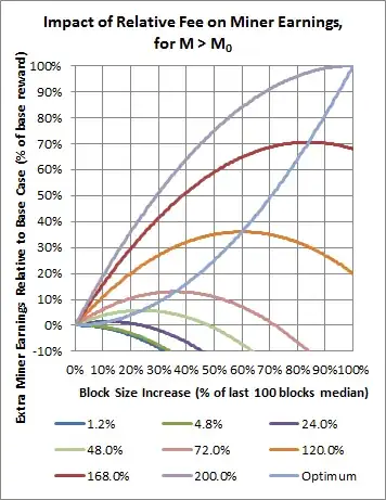

The relationship can also be observed in the below chart.

We can plot the relationship for various f_n, as seen below.
Wherever the parabolas cross the x-axis, is the point of neutral blocksize increase. The "sweet spot" is the tip of each parabola, where the miner would earn the maximum possible for a given fee. These are joined by a curve called the optimum curve. For any given TX-pool state, a miner should arrange his block such that it lies as close as possible to that curve.
The current dynamic minimum fee is the curve for f_n = 1.2% which is arbitrarily chosen. It could be any other. It matches priority = 1 in the wallet setting. This means that if everyone offered the minimum fee, miners would still have incentive to increase the blocksize up to 1.2% if the TX-pool is full.
