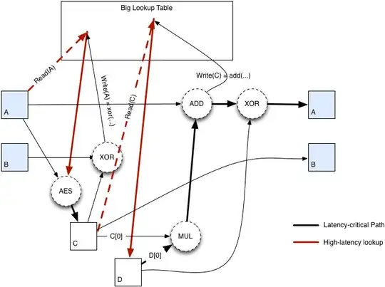

Here's a schematic of CryptoNight algorithm:CryptoNight Source
In the node software, the hash function is called cn_slow_hash, see here. Also, there's a JavaScript implementation as well which may be easier to study.
Looking into code of some existing miners should help you as well:
https://github.com/OhGodAPet/wolf-xmr-miner/releases
https://github.com/fireice-uk/xmr-stak-cpu/releases
https://github.com/xmrig/xmrig/releases
