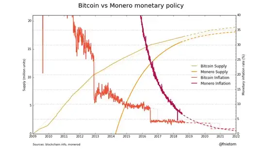

Calculated for you:
XMRs produced each year:
2014: 5.5 mi XMR
2015: 5.1 mi XMR
2016: 3.1 mi XMR
2017: 1.8 mi XMR
2018: 1.1 mi XMR
2019: 685,000 XMR
2020: 415,000 XMR
2021: 251,000 XMR
2022: 164,000 XMR
2023 and following years: 158,000 XMR/year
