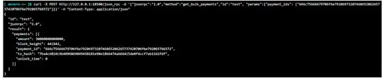

You can simply type payments <payment_ID> into the wallet to see all transactions belong to that account. If you need to check for payments programmatically, then see below from the "Accepting Monero Payments" page:
Checking for a Payment Programatically
In order to check for a payment programatically you can use the get_payments or get_bulk_payments JSON RPC API calls.
get_payments: this requires a payment_id parameter with a single payment ID.
get_bulk_payments: this is the preferred method, and requires two parameters, payment_ids - a JSON array of payment IDs - and an optional min_block_height - the block height to scan from.
An example of returned data is as follows:
Example
It is important to note that the amounts returned are in base Monero units and not in the display units normally used in end-user applications. Also, since a transaction will typically have multiple outputs that add up to the total required for the payment, the amounts should be grouped by the tx_hash or the payment_id and added together. Additionally, as multiple outputs can have the same amount, it is imperative not to try and filter out the returned data from a single get_bulk_payments call.
Before scanning for payments it is useful to check against the daemon RPC API (the get_info RPC call) to see if additional blocks have been received. Typically you would want to then scan only from that received block on by specifying it as the min_block_height to get_bulk_payments.
