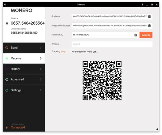

Using the Monero Core GUI, for which a beta was released on December 22nd 2016, it is also possible to display a QR-code on the "Receive" page:
It even allows to embed a payment ID, e.g. when scanned the above results in:
monero:44AFFq5kSiGBoZ4NMDwYtN18obc8AemS33DBLWs3H7otXft3XjrpDtQGv7SqSsaBYBb98uNbr2VBBEt7f2wfn3RVGQBEP3A?tx_payment_id=657c5df1563fd943
Unfortunately the balance shown in the above screenshot isn't from my own wallet, just a watch-only wallet of the Monero Project's donation address.
