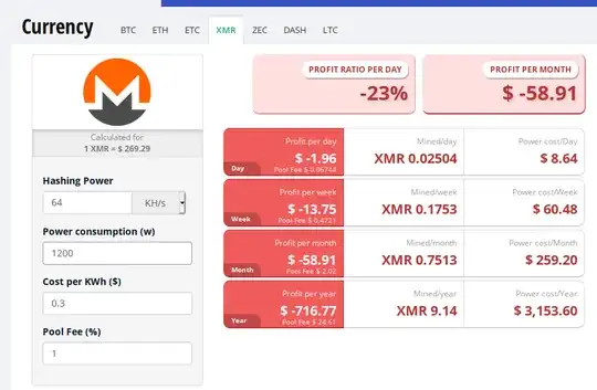

I was doing a research on building a monero mining rig and found this site where they benchmarked some hardware and their respective hashrate, and also using a online mining calculator it seems that is not worth, taking for example a AMD THREADRIPPER 3990X which according to their site has a hashrate of 64Kh/s and puting those data on the mining calculator it still not worth it:
So my question is, am I doing something wrong in this calculation or does it still worth mine it? Or maybe, is the benchmark values wrong? By the way, I was thinking about using a geforce 970 which is inferior to the threadripper quoted but I didn't found the hashrate for it...

It's "worth it" profitability wise if your cost of running is less than the revenue you can make. Thus you need cheap electricity / low power consumption system. This is why many people mine using AMD Ryzen 3000 series CPUs; the hash/watt ratio is high.
So my question is, am I doing something wrong in this calculation...?
If you're going to use some random online calculator, make sure you put in accurate values and double check the calculations yourself. For example, your system power consumption is probably not 1200W, unless you also have a couple of power hungry GPUs in it. Your electricity cost probably also isn't 30c kw/h as that's higher than even NYC; if that really is your power cost, then mining Monero almost certainly will be unprofitable for you.
