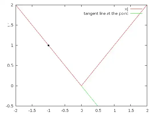

What does the derivative represent? The slope of the tangent line. Looking at different values of the absolute value function in some plots:
gif of |x|
Note that the tangent line is below the actual line for the absolute value function.

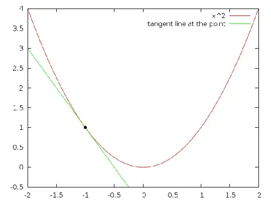

The problem with the derivative at $x=0$ is that it changes abrubtly, and derivatives don't like that. Compare to the same plot but with $x^2$
gif of x^2
The difference is clear, the tangent line smoothly changes when approaching $x=0$ instead of the abrubt change from one line to another. This is why the derivative does not exist at $x=0$ for $|x|$.
