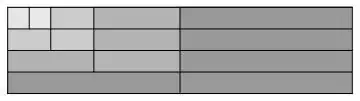

Visual proof: I would suggest modifying $$ \sum_{i=1}^n i\,2^i=2+(n-1)2^{n+1} $$ by dropping the first term in the sum on the left and the term $2$ on the right. Then replace $n$ with $n+1$ to get $$ \sum_{i=2}^{n+1} i\,2^i=n\,2^{n+2}. $$ Divide both sides by $2^2$ and reindex the sum to obtain the equivalent identity, $$ \sum_{i=1}^n (i+1)\,2^{i-1}=n\,2^n, $$ which has the visual proof shown below.
Relationship between the visual proof and the preceding bijective proof: We can see the diagram as a proof that $$ \sum_{i=2}^5i\,2^i=4\cdot2^6. $$ Imagine the rectangle divided into $2^6=64$ columns. So the light gray rectangle in the upper left would get divided into four columns, as would the adjacent light gray rectangle; the next, slightly darker gray rectangle would get divided into eight columns, and so on. Label columns from left to right by subsets $S\subseteq\{0,1,2,\ldots,5\}$ using the natural ordering $\{\},$ $\{0\},$ $\{1\},$ $\{0,1\},$ $\{2\},$ $\{0,2\},$ $\{1,2\},$ $\{0,1,2\},$ $\{3\},\ \ldots.$ Label rows from top to bottom by integers $p=1,2,3,4.$
So the column labels $\{\},$ $\{0\},$ $\{1\},$ $\{0,1\}$ would appear above the first light gray block, the labels $\{2\},$ $\{0,2\},$ $\{1,2\}$ above the second light gray block, the labels $\{3\},\ \ldots$, $\{0,1,2,3\}$ above the next, slightly darker gray block, and so on.
The pairs $(S,p)$ to which rule $4$ in the bijection above applies fall within the first block of each row of the diagram; the pairs to which rule $3$ applies all fall within the later blocks of each row.

The visual proof is also combinatorial in this sense—in some ways, it is even better. It is a double-counting proof in which the rectangle area (which consists of unit squares) is computed in two different ways—on the left by adding L-shaped regions, on the right by the trivial area formula. In another sense, however, the visual proof is not combinatorial. The exponential function $2^n$ is not given combinatorial meaning (say as the size of the power set). Only an arithmetical property is used, namely that $2^n=2^{n-1}+2^{n-1}.$
