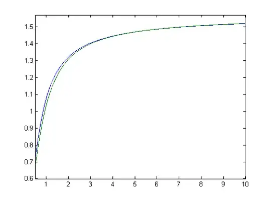

Now for example if $x=1$ then if we neglect the messy last integral in the formula then the approximation $$\sum_{n=1}^\infty \frac{x}{x^2+n^2}\approx \frac{\pi}{2}-\arctan(1/x)+\frac{x}{2x^2+2}$$is very crude. The apprximation is $1.0353981$ for $x=1$ which is quite far from the $1/2(\pi\coth(\pi)-1)\approx 1.0766740$ given in the link provided by JessicaK. However with large $x$ the approximation is serviceable. For example for $x=1000$ i get $1.570296326$ which is pretty close to $\pi/2=1.5707963267$ which is the value that you proved convergence to as $x\rightarrow \infty$.
This is how the approximation (green) looks vs. the series (blue) for $0.5\leq x\leq 10$
The above approximation is exactly what I was using! I obtained it by simple improper integration, and it works quite well, beacause the supremum is attained at $+\infty$... – Alexander Kuleshov Oct 18 '14 at 03:21
A nice picture... By the way, Which program is the best one for drawing such plots? Mathlab? – Alexander Kuleshov Oct 18 '14 at 15:09
