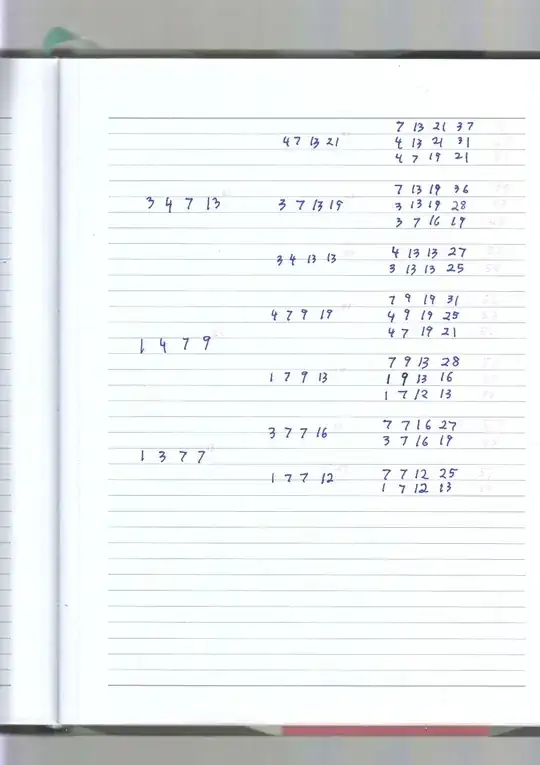

The main thing to realize is that, given any integer solution $(w,x,y,z),$ we get four neighboring solutions, $$ (x + y + z - w,x,y,z), $$ $$ (w, w + y + z - x,y,z), $$ $$ (w, x, w + x + z -y,z), $$ $$ (w, x,y, w + x + y -z). $$ There is a good deal more to say but my dinner is ready.
Later: ran on computer, it appears that the big difference from Apollonian is that we can take all entries positive, with the single (primitive) exception of the root $(0,1,1,1).$ More work to do.
Alright, I think already that this has a greater resemblance to http://en.wikipedia.org/wiki/Markov_number That is, if, for example, we always re-order so that $w \leq x \leq y \leq z,$ then the first three flips written above give new quadruples, while flipping the largest, $z,$ returns us to a previous quadruple (i.e. decreases $w+x+y+z$). That is, solutions make up a single tree, with a single root. However, in comparison to the Markov tree, there are plenty of quadruples with repeated entries.
Proof of all these apparent patterns is likely to be fairly long. I can tell you already, though, that a big part of it is showing that the only solution with $ \; \; 0 \leq w \leq x \leq y \leq z, \; \; \; \; \gcd(w,x,y,z) = 1,$ and $w + x + y \geq 2 z,$ is $(0,1,1,1).$ Usually but not always easier, one must show there are no solutions with some negative and some positive entries. False for the Apollonian case, appears true here. Big difference caused by just changing one multiplier from 2 to 1.

The fastest growth is along the branch where a quadruple is four consecutive values of the sequence $$ 1,3,4,7,13,21,37,64,109,189,325,559,964,1659, 2857,4921, \ldots $$ which satisfy $$ a_{n+4} = a_{n+3} + a_{n+2} + a_{n+1} - a_n. $$ The characteristic polynomial for this is $$ x^4 - x^3 - x^2 - x + 1 = \left( x^2 - \left(\frac{\sqrt {13}+1}{2} \right) x + 1 \right) \left( x^2 + \left(\frac{\sqrt {13}-1}{2} \right) x + 1 \right) $$ The quadratic factor on the left gives two real positive roots, the largest is $1.7220838...,$ the other smaller than 1. The quadratic factor on the right gives complex conjugate roots of magnitude exactly $1,$ so their contribution to $a_n$ does not completely die out but does stay bounded.
Alright, it all worked out. With $w \leq x \leq y \leq z$ a solution, we cannot have $w \leq x < 0 < y \leq z$ because $$ (w^2 - w x + x^2) + (y^2 - yz+z^2) = (w + x)(y + z). $$ This is a minor variant of an inequality on page 14 of Graham et al., link to arXiv above. Next, we cannot have $w = x + y + z = 0$ for a nontrivial solution, because $w = -(x+y+z)$ implies $3 (x^2 + y^2 + z^2 + yz+zx+xy ) = 0,$ but this is a positive definite form and thus $x=y=z=0$ and $w=0.$ Taking $w+x+y+z > 0$ as a hypothesis, the 1907 technique of Hurwitz on finding a Grundlösung ($w + x + y \geq 2 z$) with inequalities first give $w \geq 0,$ then $z=y=x$ and $w=0.$ In order to have the GCD turn into one we have $z=y=x=1.$
So, the whole thing really is a tree, single root, any solution can be reduced to $(0,1,1,1)$ in a finite number of steps(of the four types above), along with re-ordering at need.
Saturday: slight change, the thing is not quite a tree, although it remains a partially ordered set in which any (ordered) quadruple can be reduced to $(0,1,1,1)$ in a finite number of steps, each time strictly reducing $w+x+y+z.$ The surprise for me was that $(1,7,12,13)$ can reduced to either $(1,7,12,7),$ ordered $(1,7,7,12),$ or $(1,7,9,13),$ already ordered. Below are the first few layers of the poset, building off $(1,3,4,7):$
The first three dozen solution quadruples that reduce in two distinct ways, ordered by $w+x+y+z,$ are
