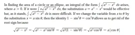

I'm learning Trigonometric Substitutions, they gave us the following example in the book:
I'm confused about how exactly we make the substitution $x= a\sin(\theta)$
In regular substitution we have to take something from the integrand and substitute it for u. Why is it in this case we can use $a\sin(\theta)$ when I do not see it in the integrand?
