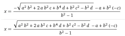

Wolfram alpha solves it no problem:
solution
