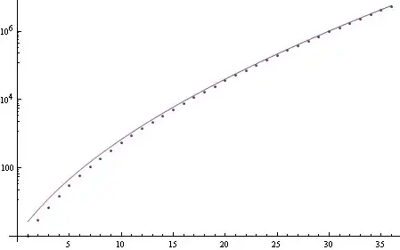

The first $36$ values are:
1, 3, 7, 15, 30, 58, 105, 186, 318, 530, 863, 1380, 2164, 3345, 5096, 7665, 11395, 16765, 24418, 35251, 50460, 71669, 101050, 141510, 196888, 272293, 374423, 512081, 696760, 943442, 1271527, 1706159, 2279700, 3033772, 4021695, 5311627
Here’s a (lin-log) graph, also showing the curve for Joriki’s asymptotic expression $\frac{1}{8 n \sqrt{3}} e^{\pi \sqrt{\frac{4 n}{3}}}$.
$\hspace{1in}$ graph
The list was generated using
Length@IntegerPartitions[2n, All, Range[n]]
in Mathematica.
