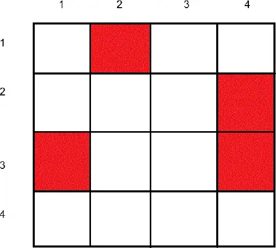

The easiest thing to do would be to draw out your diagram first. Given the information in the problem as stated, a reasonable chess board would be given as
Image of Chess board without re-ordering
For this chess board, the numbers on the left column represent the numbers to be permuted, the numbers along the top row represent the positions that a number can go to. A square that is shaded red is a forbidden region (for example, the square at row 1, column 2 is forbidden since you state in the problem description that the number 1 can not go to position #2).

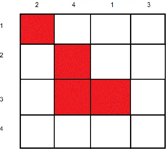

We can reorganize the columns to make a chess board that is easier to work with like the one below.
Image of chess board with reordered columns.
Seeing as there are far fewer forbidden positions than allowed positions, your guess that counting the number of ways to place a number into a forbidden position, and then subtracting from the total number of ways to permute the numbers is actually a good idea.
Because of the way I reordered the chess board, determining the rook polynomials for the forbidden regions is relatively easy.
The rook polynomial for the red square at row 1, column 2 is (1 + x). The rook polynomial for the other forbidden region is (1 + 3x + x2). Seeing as both of these regions are disjoint (meaning that neither region shares a row or a column), we simply multiply both polynomials together, yielding
1 + 4x + 4x2 + x3
We now use the Principle of Inclusion and Exclusion to count the number of possible arrangements where no number gets sent to a forbidden position.
Let rk be the coefficient of xk in the rook polynomial (1 + 4x + 4x2 + x3).
Without regard to forbidden positions, there are r0(4!) = 1 * 4! ways to permute the numbers.
We now subtract off the number of permutations where at least one number is in a forbidden position, given by r1(3!) = 4*3!.
But we subtracted off twice as many permutations with at least 2 numbers in forbidden positions, so we must add on one of each, given by r2(2!) = 4*2!.
In adding on the previous term, we have twice counted the number of permutations with 3 of the numbers in forbidden positions, so we must subtract off those permutations one more time, given by r3(1!) = 1*1!.
The final answer is given by (1 * 4!) - (4 * 3!) + (4 * 2!) - (1 * 1!).
We could simplify: (1 * 4!) - (4 * 3!) + (4 * 2!) - (1 * 1!) = 24 - 24 + 8 - 1 = 7.
There are a total of 7 ways to permute the numbers 1,2,3,4 such that 1 does not go to position #2, 2 does not go to position #4, and 3 does not go to position #1 or position #4.
