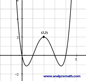

(Here is the polynomial $f(x) = 2x^4 - x^3 -3x^2 + 7x - 13$. It is degree 4 and it has the maximum number of turning points, 4-1=3. But, keep in mind, some degree 4 polynomials have only one or two turning points. The degree gives us the MAXIMUM number: $n-1$.)
This is important because, if you want to use a polynomial to approximate a function, you will want to use a polynomial of high enough degree to match the "features" of the function. The Taylor series will let you do this with functions that are "infinitely differentiable" since it uses the derivatives of the function to approximate the functions behavior.

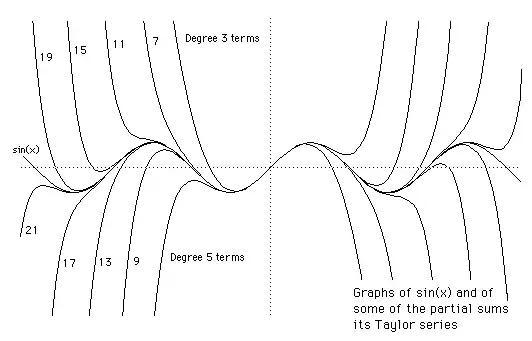

Here are Taylor polynomials of increasing degree and the sine curve. Notice how they are "wrapping around" the sine curve, giving an approximation that fits better and better over more of the curve as the degree of the Taylor polynomial increases.
(Source for this image: http://202.38.126.65/navigate/math/history/Mathematicians/Taylor.html)
Since the sine curve has so many turning points it is easy to see that to match all of the features of the sine curve we will need to take the limit of the $n^{th}$ degree Taylor polynomial as $n \rightarrow \infty$.*
That's the intuition behind the Taylor series. The higher the degree, the better the "fit." Why? Because higher degree curve have more "turning points" so they can better match the shape of things like the sine function. (As long as the function we are approximating is differentiable.)
