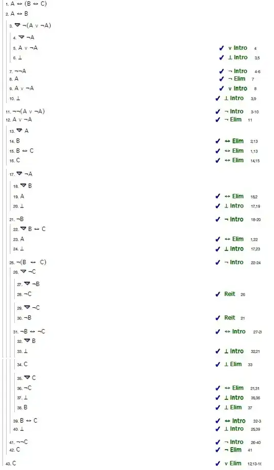

Due to the transitivity of $\leftrightarrow$ and due to the fact that $A$ comes up on both premises 'at the same level', I find it natural to focus on $A$ and let it act as a pivot of sorts.
Start by proving $A\lor \neg A$ and perform $\lor$-$\text{Elim}$ on this disjunction.
In the first case just use $\leftrightarrow$-$\text{Elim}$ successively on the premises to get $C$.
In the second case (where one starts a subproof with the premise $\neg A$), use the premise $A\leftrightarrow B$ to get $\neg B$ and the premise $A\leftrightarrow (B \leftrightarrow C)$ to get $\neg(B\leftrightarrow C)$ (in both cases by negation introduction).
Now assume $\neg C$, prove $\neg B\leftrightarrow \neg C$ and from this last statement get $B\leftrightarrow C$.
At this point you can find a contradiction allowing you to conclude $C$ in the subproof whose premise is $\neg A$.
I leave the proof below.
Formal proof
Git Gud
  • 31,706
    The software that comes with the book doesn't seem to deal well with big proofs.This was the best possible presentation I could get. One can note that in justification of the steps there are some missing steps, the software itself did that. – Git Gud Sep 20 '14 at 22:18
