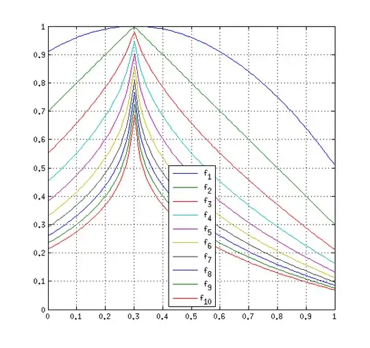

Recall, that the Kronecker delta is defined as \begin{align} \delta_{ij} = \begin{cases} 1, \quad i=j \\ 0, \quad i\not = j\end{cases} \end{align} Now consider the sequence $f_n: [0,1]\rightarrow \mathbb{R}$ with \begin{align} f_n(x) = 1-\sqrt[n] x \rightarrow f(x) = \begin{cases} 1, \quad x = 0\\ 0, \quad x\not =0\end{cases} \end{align} or more similar to the Kronecker delta with $j\in [0,1]$ and again $f_n^j: [0,1]\rightarrow \mathbb{R}$ \begin{align} f_n^j(x) = 1-\sqrt[n] {(x-j)^2} \rightarrow f^j(x) = \begin{cases} 1, \quad x=j\\ 0, \quad x\not = j\,\wedge 0\leq x \leq 1\end{cases} \end{align} Since $f^j:[0,1]\rightarrow \mathbb{N}$ and $f^j(i)\equiv \delta_{ij}$ for $i,j\in [0,1]$, $f_n^j$ converges towards the Kronecker delta (on $[0,1]$).
The following plot shows $f_n^{0.3}(x)$ for different values of $n$ which converges towards $f_\infty^{0.3}(x) =f^{0.3}(x)= \delta_{x,0.3}$

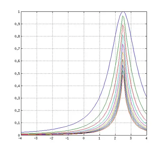

Simply use $f^j_n(x) = 1-\sqrt[n]{h^j(x)}$ with $h^j(x) = 1-\frac{1}{1-(x-j)^2}$. Then $h_j(j) = 0$ and $h_j(x)\not = 0$ for $x\not = j$ and thus $f$ is defined on $\mathbb{R}$.
Here you can see a plot of $f_n^{2.5}(x)$ for $-4<x<4$. enter image description here
