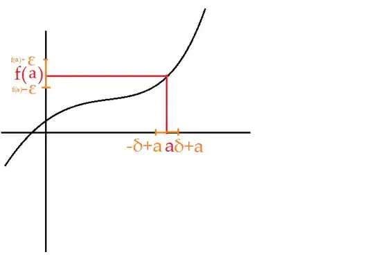

The Delta-Epsilon definition basically states that for every point ( however close that may be to the limiting point but not exactly on that point) there would a be point in y-axis near the limiting value, for a limit to exist.
