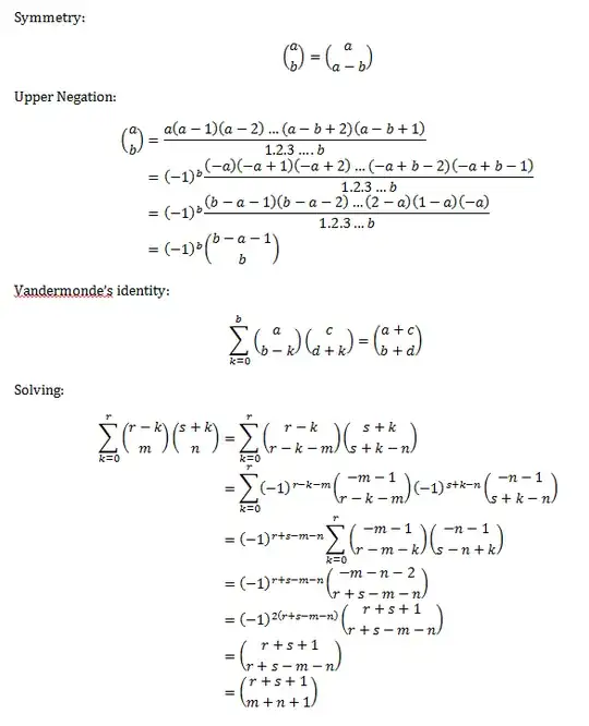

Apply the following in order:
  • symmetry to get the summation index $k$ to appear at the bottom
  • upper negation to remove $k$ from the top
  • Vandermonde's identity to settle the summation and remove $k$
  • upper negation to make $r, s$ appear at the top
  • symmetry to remove $r, s$ from the bottom.
