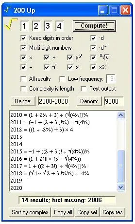

So there's where it gets interesting. My first thought was "computer search -- done". But it's not as easy as that, because factorial is only a unary operator. For example one has to rule out any possible amazing cancellations between very large numbers, e.g. one has to check
$$(1+2)!!!!!!!!!!!!!-3^{(4!!!!!!!!!!!)} \neq 2011.$$
This one in particular is not hard to rule out, because, for example, the left hand side is a multiple of $3$ and the right hand side isn't. In general, this approach can perhaps be used to bound the number of factorials that can occur in any presentation of $2011$ using $1, 2, 3, 4$ only -- but making this rigorous seemed a bit delicate and I wondered if I was missing something. Anyone any ideas?

It is very likely that your friend did a search of this sort for the case n=5 to find the special solution.

If square roots and percentages (and unary minus) are permitted, then there are a number of solutions, the simplest probably being
$$2011 = (-1 + (2 + 3!)!\%) \div \sqrt{4\%}$$
Many years ago, I wrote a simple Windows program called $200$ Up (link to Dropbox folder) for solving problems like these:
$\hspace{1.75in}$ 200 Up
The domain of calculation is $\mathbb{Z}/d$ for some specified denominator $d\in\mathbb{N}$ (and with limits on the magnitude of the numerator).
Note that, in the image above, the solution for 2018 is
$$ \large 2018 \;\;=\;\; \big( \sqrt[\sqrt{\cdot \dot{1}}]{\Large 2} \; + \; 3!!\%\% \big) \; \div \; \cdot 4\%. $$

    I don't care whether or not percentages are allowed -- this makes me just as happy as the construction using 1 to 5 I quoted above. And you do 2012 too! What happens if you take percentage off and then search again for 2011? – Kevin Buzzard Dec 21 '11 at 19:10
  • @KevinBuzzard: No solution is found for $2011$ without percentages. With the rules as specified, the only solutions found for this century are $2016 = (1 + 2)!! + 3!^4$ and $2088 = (1 + 2) \times (3!! - 4!)$. If the digits don't have to remain in order, we also have $2024 = 4!! \div (21! \times 3!)$ and $2048 = 2^{13} \div 4$. – David Bevan Dec 21 '11 at 19:57
