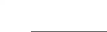

Quadrilaterals are not rigid: you can fix a side and move one of the other vertices freely while respecting all side lengths. The area changes when you move the vertex.
(image from http://www.mathsisfun.com/definitions/rigid.html)
lhf
  • 221,500
Here you see that the area is not determined. The animation uses parallelograms with side lengths $a=c=3$, $b=d=2$, so the area varies between $0$ and $6$. In general the minimum area may not be exactly zero as here, but the same thing happens always.
