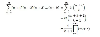

For completeness, a solution using the combinatorial/binomial approach, as initiated by RobJohn:
$\newcommand{\angles}[1]{\left\langle\, #1 \,\right\rangle} \newcommand{\braces}[1]{\left\lbrace\, #1 \,\right\rbrace} \newcommand{\bracks}[1]{\left\lbrack\, #1 \,\right\rbrack} \newcommand{\ceil}[1]{\,\left\lceil\, #1 \,\right\rceil\,} \newcommand{\dd}{{\rm d}} \newcommand{\ds}[1]{\displaystyle{#1}} \newcommand{\expo}[1]{\,{\rm e}^{#1}\,} \newcommand{\fermi}{\,{\rm f}} \newcommand{\floor}[1]{\,\left\lfloor #1 \right\rfloor\,} \newcommand{\half}{{1 \over 2}} \newcommand{\ic}{{\rm i}} \newcommand{\iff}{\Longleftrightarrow} \newcommand{\imp}{\Longrightarrow} \newcommand{\pars}[1]{\left(\, #1 \,\right)} \newcommand{\partiald}[3][]{\frac{\partial^{#1} #2}{\partial #3^{#1}}} \newcommand{\pp}{{\cal P}} \newcommand{\root}[2][]{\,\sqrt[#1]{\vphantom{\large A}\,#2\,}\,} \newcommand{\sech}{\,{\rm sech}} \newcommand{\sgn}{\,{\rm sgn}} \newcommand{\totald}[3][]{\frac{{\rm d}^{#1} #2}{{\rm d} #3^{#1}}} \newcommand{\verts}[1]{\left\vert\, #1 \,\right\vert}$ \begin{align}&\color{#c00000}{\sum_{n = 0}^{m}\pars{n + 1}\ldots\pars{n + k}}= \sum_{n = 0}^{m}{\pars{n + k}! \over n!} =k!\sum_{n = 0}^{m}{n + k \choose k} =k!\sum_{n = 0}^{m}\oint_{\verts{z}\ =\ 1}{\pars{1 + z}^{n + k} \over z^{k + 1}} \,{\dd z \over 2\pi\ic} \\[3mm]&=k!\oint_{\verts{z}\ =\ 1}{\pars{1 + z}^{k} \over z^{k + 1}} \sum_{n = 0}^{m}\pars{1 + z}^{n}\,{\dd z \over 2\pi\ic} =k!\oint_{\verts{z}\ =\ 1}{\pars{1 + z}^{k} \over z^{k + 1}} {\pars{1 + z}^{m + 1} - 1 \over \pars{1 + z} - 1}\,{\dd z \over 2\pi\ic} \\[3mm]&=k!\bracks{\oint_{\verts{z}\ =\ 1} {\pars{1 + z}^{k + m + 1} \over z^{k + 2}}\,{\dd z \over 2\pi\ic} -\oint_{\verts{z}\ =\ 1}{\pars{1 + z}^{k} \over z^{k + 2}}}\,{\dd z \over 2\pi\ic} \\[3mm]&=k!\bracks{{k + m + 1 \choose k + 1} - {k \choose k + 1}} \end{align}
$$ \color{#66f}{\large\sum_{n = 0}^{m}\pars{n + 1}\ldots\pars{n + k} =k!\,{k + m + 1 \choose m}} $$
