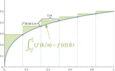

This was brought up recently in chat and I wrote this up. This question seemed like a good home.
As hinted in the following diagram
Riemann sum error $$ \int_{\frac{k-1}n}^{\frac{k}n}(f(k/n)-f(t))\,\mathrm{d}t\sim\frac{f'(k/n)}{2n^2}\tag1 $$ In fact, integration by parts and the mean value theorem yield for some $\xi\in\left(\frac{k-1}n,\frac{k}n\right)$: $$ \begin{align} \int_{\frac{k-1}n}^{\frac{k}n}(f(k/n)-f(t))\,\mathrm{d}t &=\int_{\frac{k-1}n}^{\frac{k}n}\left(t-\frac{k-1}n\right)f'(t)\,\mathrm{d}t\tag{2a}\\ &=\frac{f'(k/n)}{2n^2}-\int_{\frac{k-1}n}^{\frac{k}n}\frac12\left(t-\frac{k-1}n\right)^2f''(t)\,\mathrm{d}t\tag{2b}\\ &=\frac{f'(k/n)}{2n^2}-\frac1{6n^3}f''(\xi)\tag{2c} \end{align} $$ Explanation:
$\text{(2a)}$: Integration by Parts
$\text{(2b)}$: Integration by Parts
$\text{(2c)}$: Mean Value Theorem
Therefore, $$ \begin{align} \lim_{n\to\infty}\left(\sum_{k=1}^nf(k/n)-n\int_0^1f(t)\,\mathrm{d}t\right) &=\lim_{n\to\infty}\left(n\sum_{k=1}^n\int_{\frac{k-1}n}^{\frac{k}n}(f(k/n)-f(t))\,\mathrm{d}t\right)\tag{3a}\\ &=\lim_{n\to\infty}\sum_{k=1}^n\frac12f'(k/n)\,\frac1n\tag{3b}\\ &=\frac12(f(1)-f(0))\tag{3c} \end{align} $$ Explanation:
$\text{(3a)}$: break up the integral and move the sum inside the integral
$\text{(3b)}$: apply $(2)$
$\text{(3c)}$: apply Riemann Summation
robjohn
  • 353,833
