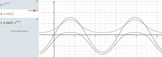

If you can get your functions in the form of:
f(t)=... and
g(t) =...
and you want the intersection, all you have to do is use Desmos Graphs
You could also do something like f(t)-g(t) = 0 and the graph of the result will show the intersection as well.
After the graph is displayed, you can place the mouse on the graph to show the point of interest. It helps when you color the graphs.
Example

  • That's some useful software, but do you know of any libraries that i can actually incorporate into my physics engine? – Griffin Dec 14 '11 at 23:53
  • @Griffin, what language do you want to use? Do you want the software to show graphs or solve the equations? – NoChance Dec 15 '11 at 08:24
  • Solve the equations, and I use c++ – Griffin Dec 15 '11 at 22:44
    I am not an expert in C++ but you could check these: http://en.wikipedia.org/wiki/NAG_Numerical_Libraries and http://en.wikipedia.org/wiki/List_of_numerical_libraries also, MATLAB can be called from C++ to the best of my knowledge. I hope this answers your questions. – NoChance Dec 15 '11 at 23:57
