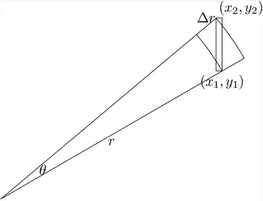

$$((r+\Delta r) \cos(a +\Delta \theta) -r \cos a) \cdot ((r+\Delta r) \sin(a + \Delta \theta) -r \sin a) / (r \;\Delta \theta \; \Delta r)=1 .$$ where the variable represent as in this graph :
sketch of the situation
as $\Delta r $ and $\Delta \theta$ approach $0$
This question is inspired from $dx\;dy=r \;dr \;d \theta$.

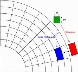

A small area in $\mathrm{d}r\;\mathrm{d}\theta$, the green square, is mapped by the polar coordinate map to the blue annular wedge, which has approximately the same area as the red rectangle. The Jacobian matrix maps the green square to the red rectangle. The ratio of the area of the red rectangle to the green square is the determinant of the Jacobian (this is just linear algebra).
Jacobian
Therefore, since a small square in $\mathrm{d}r\;\mathrm{d}\theta$ is mapped by the coordinate transform so that its area is $\left|\frac{\partial(x,y)}{\partial(r,\theta)}\right|\;\mathrm{d}r\;\mathrm{d}\theta$ $$ \begin{align} \iint f(x,y)\;\mathrm{d}x\;\mathrm{d}y &=\iint f(r,\theta)\left|\frac{\partial(x,y)}{\partial(r,\theta)}\right|\;\mathrm{d}r\;\mathrm{d}\theta\\ &=\iint f(r,\theta)\;r\;\mathrm{d}r\;\mathrm{d}\theta\tag{3} \end{align} $$

I've understood your question as the question whether $$\lim\limits_{\substack{\Delta r\to 0\\\Delta a\to 0}} \frac{((r+\Delta r) \cos(a +\Delta \theta) -r \cos a) \cdot ((r+\Delta r) \sin(a + \Delta \theta) -r \sin a)}{r \;\Delta \theta \; \Delta r}=1.$$ I hope this was correct.
The expression you're asking about has the form $[f(a+\Delta a,r+\Delta r)-f(a,r)]\cdot[g(a+\Delta a,r+\Delta r)-g(a,r)]$ for the functions $$f(a,r)=r\cos a$$ $$g(a,r)=r\sin a$$

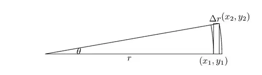

The following picture should show what this expression represents. (With $(x_1,y_1)=(r\cos a,r\sin a)$ and $(x_2,y_2)$ the same for $r+\Delta r$ and $a+\Delta a$, the given expression is just the are of rectangle in the picture.)
Generic position
The partial derivatives of these functions are $f_r(a,r)=\cos a$, $f_a(a,r)=-r\sin a$, $g_r(a,r)=\sin a$, $g_a(a,r)=r\cos a$.
Using the first order Taylor polynomial we can approximate this expression as $$(\cos a \Delta r-r\sin a\Delta a)(\sin a\Delta r+r\cos a\Delta a)=$$ $$\cos a\sin a (\Delta r)^2 + r(\cos^2a-\sin^2a) \Delta a \Delta r - r^2 \sin a \cos a (\Delta a)^2.$$

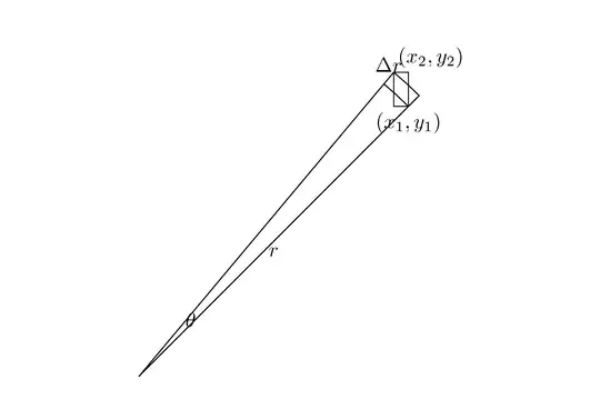

Let us check at lest in some special cases whether we get what we would expect.

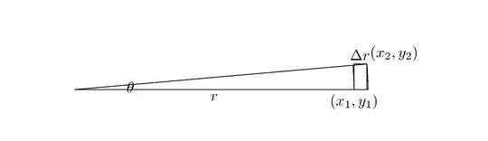

If $a\approx 0$, then the above expression is close to $r\Delta a\Delta r$. From the following figures we see, that we would really expect it to approximate quite well the area between the two arcs.
r approx 0
r approx 0

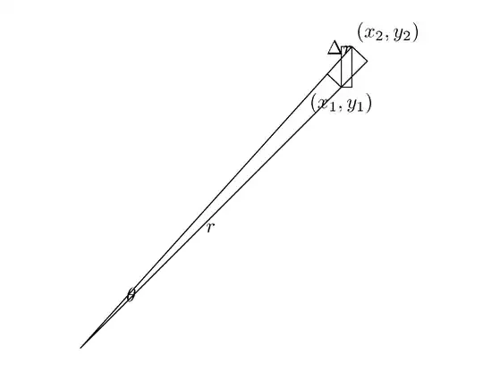

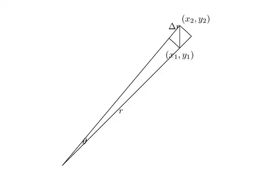

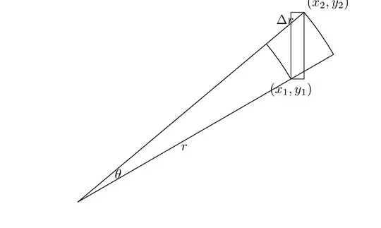

But for $\cos a=\sin a = \frac{\sqrt 2}2$ this expression is approximately $\frac{(\Delta r)^2}2-r^2\sin a\cos a(\Delta a)^2$. The following picture show that it can really attain positive values, values close to zero, and negative values.
close to 45 deg
close to 45 deg
close to 45 deg
