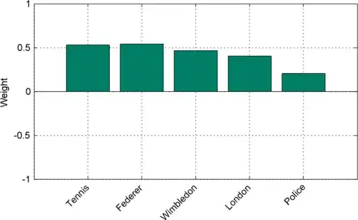

Now the columns of u contain information on how your words are related to each other and s contains information on how much information from the underlying table is contained in each column. Since all of your weights are greater than zero, the first column simply says that all of the weights are related (e.g. if your weights are correlations in search traffic, you can think of this as saying that each term increases when the overall amount of search traffic increases):
>> u(:,1)
ans =
0.5307
0.5419
0.4668
0.4054
0.2064

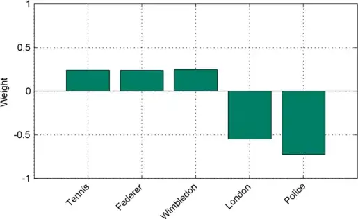

The second column of u contains information on how the search terms cluster together:
>> u(:,2)
ans =
 0.2396
 0.2380
 0.2475
-0.5478
-0.7243
This is telling you that the first three terms ("tennis", "Federer" and "Wimbledon") are related to each other, as are the second two ("London", "police")
