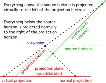

This is possible for any strictly-convex quadrilateral. In another answer, I compute a $2{-}\mathrm{D}$ to $2{-}\mathrm{D}$ perspective map that maps any $4$ points to any other $4$ points. This perspective map essentially projects $4$ points in one plane to another plane by projecting from a given viewpoint.
Strict-convexity insures that no points of the square need to be virtually projected from behind the viewpoint onto the plane of the quadrilateral. For example, if $1$ or $3$ points of the square are virtually projected, the quadrilateral will be concave; if $2$ points of the square are virtually projected, two sides of the quadrilateral will cross.
Edit: In the case of virtual projection, I said that the quadrilateral will be convex or that two of its sides will cross. That would be if the corners were mapped and connected in order. If the sides were projected, they would actually shoot off to infinity since the sides of the square cross the source horizon (the plane parallel to the projection plane, but passing through the viewpoint).

  • I appreciate the inclusion of a diagram but I'm still a little confused about how the positioning of the viewpoint in the diagram is related to the source plane and the virtual/normal projections. What confuses me is that the viewpoint is between the virtual projection and the source plan. Can you please clarify this? – Sp3000 Jan 10 '12 at 03:17
  • @Sp3000: Looking at the projection plane, you don't see the virtually projected points because, as you say, they are behind the viewpoint. However, the virtual projections are on the line containing the viewpoint and the source point, so mathematically they get mapped onto the projection plane. – robjohn Jan 10 '12 at 07:40
