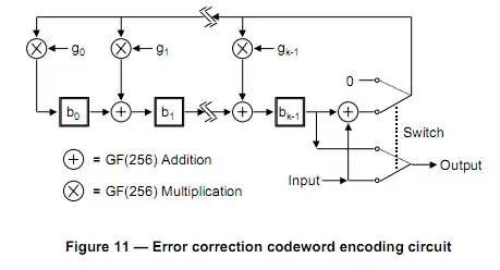

I am attempting to generate QR codes on an extremely limited embedded platform. Everything in the specification seems fairly straightforward except for generating the error correction codewords. I have looked at a bunch of existing implementations, and they all try to implement a bunch of polynomial math that goes straight over my head, particularly with regards to the Galois fields. The most straightforward way I can see, both in mathematical complexity and in memory requirements is a circuit concept that is laid out in the spec itself:
circuit diagram
With their description, I am fairly confident I could implement this with the exception of the parts labeled GF(256) addition and GF(256) Multiplication.

There are two advantages of this approach for the QR code application First, if $d(x)$ is chosen to be the polynomial being fed back and $c(x)$ one of the $g^{(j)}(x)$, then the coefficients of $c(x)$ are fixed and known ahead of time, and so the first of the two steps above can be simplified. Second, since the same $d(x)$ is being used to multiply $k$ different $g^{(j)}(x)$'s, the update of $d(x)$ can be shared among the $k$ different multiplications if they are arranged to proceed in parallel instead of one by one. Also, as a minor improvement, since the product $e(x)$ is to be added to a $b(x)$, $e(x)$ can be initialized to have value $b(x)$ instead of the zero polynomial.
