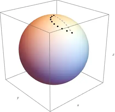

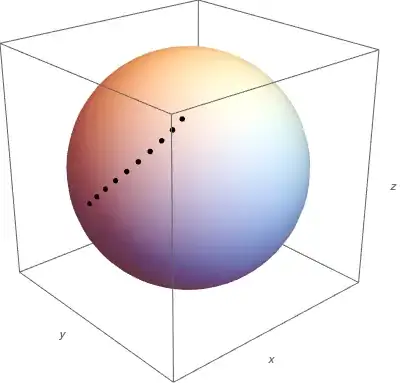

If you only care about the beginning and end, you can express any rotation with the Euler angles. But if you want a smooth transition between the beginning and the end, then with some starting orientations, you have a problem, and this is called the gimbal lock.
For example, here we start from (x,y,z) = (1,0,0) and simultaneously turn yaw left and lift pitch up at 5 degree steps, until both reach 45 degrees. The black dots move on the surface of the unit sphere. (Roll could be whatever, it cannot be seen as I am only plotting dots.)
Rotation: yaw 45, pitch 45
But say, we start from a position pointing directly upwards, so our object is pointing to (x,y,z) = (0,0,1) and we want to rotate it down around the x-axis by 45 degrees. Now we have to turn yaw (or heading) 90 degrees, and lower the pitch 45 degrees (and perhaps roll -90 degrees, depending what orientation we want, but my dots cannot illustrate this).
Now if we do the yaw and pitch transformations simultaneously:
(yaw=0,pitch=0), (yaw=5,pitch=-5), (yaw=10,pitch=-10), ...
we get the black dots in the figure below, whereas a straight line by 5 degree turns around the x-axis is plotted with the white dots. We can still reach the same endpoint, but we cannot start to turn directly into the "correct" or "straight" direction.
Rotation: yaw 90, pitch -45
