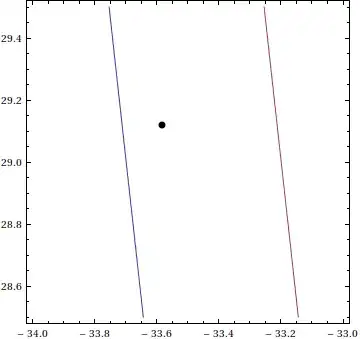

It does look as if the eighth member isn't zero; a plot of the curves $\Re((-\sqrt 2)^{x+iy})=0$ and $\Im((-\sqrt 2)^{x+iy})=0$ in the vicinity of the seventh member of the cycle gives a strong hint:
is that a zero I see?
(An analytical proof of this will still be needed, though.)

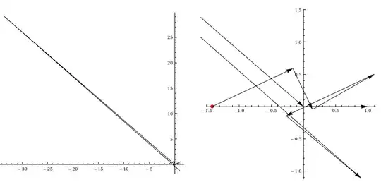

Here are plots of the complex plane trajectory. Since the seventh member of the cycle is a bit larger in magnitude than the others, I have also thrown in a close-up:
power tower trajectory
