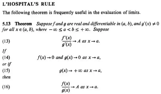

Today I saw page claiming that $\lim_{x \to a} f(x)=\infty$ is not necessary (When $\lim _{x \to a}g(x)=\infty$) . Is it true? Can it be proved that this condition isn't necessary.
Edit: To clarify, I am solving a limit problem with L.Hopital where $f(x)\neq \infty$[This doesn't prove it, I am trying to clear what I am trying to ask]

Edit: enter image description here

  • Yes, the Theorem as stated is true. You can find a proof in baby Rudin (it look like that's where your image is taken from). This question has answers with proofs here as well. See this, e.g.. – David Mitra Aug 08 '14 at 19:28
  • There are a lot of non-answers here stating that this generalization is never useful anyway. But this is not true! If the numerator has a finite limit (while the denominator has an infinite limit), then sure, the limit is zero and this result is not needed. But if you don't know what the limit of the numerator is, or if the numerator is oscillating with no limit (and is not bounded either, since this would also make the limit zero), then this result is useful! An example of its use (where the numerator is mostly unknown) is at https://math.stackexchange.com/questions/51596/#51629 – Toby Bartels Oct 28 '19 at 15:33
I think what you are looking for is the proof found in here using the Cesaro-Stolz Theorem. http://www.imomath.com/index.php?options=686
One of the cases is when $\lim_{x\to a}g(x)=\infty$ but makes no hypothesis on $f$.
Another link that may help you is this one:
In this link a proof is provided that seems to match what your picture wants.

  • @user163751 [1]: https://i.sstatic.net/IhUhD.jpg – Mathslover Aug 08 '14 at 18:58

  • That example doesn't invalidate LHR for the case of $\text{something}/\infty$. LHR states that if the limit of the denominator $g$ is $\infty$ AND limit of the quotient of derivatives $f'/g'$ exists AND $f'$ and $g'$ are continuously differentiable around the point the limits are taken, then $\lim f/g=\lim f'/g'$. – Mark Viola Nov 29 '18 at 00:00
  • This answer is wrong, because the rule also works when the numerator is arbitrary and the denominator is infinite, which is exactly what the OP was asking about. (Proofs are in the links in the answer by user71352.) In particular, the limit of the expression with $\csc x\cot x$ is zero, and so the rule is valid (despite not being useful in this case). – Toby Bartels Oct 28 '19 at 15:52
  • @MarkViola : Incidentally, $f$ and $g$ don't have to be continuously differentiable (and $f'$ and $g'$ don't have to be differentiable at all, but that was probably just a typo). Sometimes this is assumed in Calculus textbooks to simplify the proof (especially if they never state Bezout's Theorem), but it's enough that $f$ and $g$ are differentiable (and $g' \ne 0$), in other words that $f'/g'$ is defined in the direction of the limit. (See the proofs at the links in the answer by user71352, which never use continuity of the derivatives.) – Toby Bartels Oct 28 '19 at 15:56
