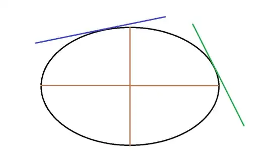

I'm attempting to draw an ellipse based on two points. For each of these points I have a vector showing the direction the curve of the ellipse should be at this point (I suppose another way of looking at it is that I have 2 tangent lines to the to the ellipse with the intersection point for each).
I know normally 2 points would not be enough to determine the ellipse, but I thought the vectors might make it possible. Ideally I'm trying to calculate the center point and the major and minor axis (I guess either the actual points or the vector from the center).
I'm not quite sure how to proceed with this, or whether it's actually possible, but any help would be greatly appreciated, thanks.
Edit: Added a simple example of what I'm talking about. For the record, the calculation will be in 3D space.
Okay, so the I have the two tangent lines illustrated here, in the form of a point and a (normalized) vector, the point being the intersection point with the ellipse (it's part of the line and the ellipse). By vectors from the center point for the axes I just meant it as an alternative way of finding the minor and major axis points, stupid thing to put in).
Edit 2: Let's assume they're not parallel.

  • Can you put a drawing? There are things not very clear (vectors from the center / tangent lines interesections???) – Martigan Aug 08 '14 at 13:21
  • Sure, give me a minute to draw something. – Incredidave Aug 08 '14 at 13:22
  • If your two lines are parallel, it is not possible, there are an infinite numbers of ellipses that fit the bill. – Martigan Aug 08 '14 at 13:32
  • Lets assume they're not. I can deal with that case separately. – Incredidave Aug 08 '14 at 13:32
    Counting multiplicity, you need 5 points to specify a conic. A point together with a tangent direction is equivalent to two points only. So two points + two directions is not enough, you need one more point or other info to fix your ellipse. – achille hui Aug 08 '14 at 13:33
  • Oh, that sucks. I'm not quite sure I understand though. I can't quite imagine any more than one ellipse fitting the two line shown above. Can you explain how others would work? – Incredidave Aug 08 '14 at 13:35
    Exact. In fact there are at least two ellipses that can fit the bill. From looking at your drawing, there is the one your drawed, and an other one with the long and short axis inverted. – Martigan Aug 08 '14 at 13:36
  • Huh, I'm still not sure I understand, do you mean the two axis swapped with each other? Or flipped 180 degrees (so visually it would look the same)? The tangents definitely wouldn't line up in the first, and for the second I'm not sure it matters? visually it's still the same, which is all I'm really concerned with. Sorry for the potentially stupid questions. – Incredidave Aug 08 '14 at 13:42
    By a linear transform, you can always bring the two line to the $x$ and $y$ axis and the two point of contact to $(1,0)$ and $(0,1)$. Given any ellipse with any eccentricity, align its major axis along the line $x = y$ and let it touch the $x$ and $y$ axis. By scaling the ellipse, you can make the two point of contact matching the two points $(0,1)$ and $(1,0)$. This means there are infinite many ellipses passing through the two given points with given tangent direction. – achille hui Aug 08 '14 at 13:45
  • Sorry, I'm having a little trouble following that. I had just assumed that the points are a set distance from each other, so while you can scale them the tangents passing through the line will rotate, making the ellipse invalid, no? (I'm not trying to prove you wrong or anything, you seem to understand this much better than me, just trying to understand) – Incredidave Aug 08 '14 at 13:51
  • To see a few of the infinitely many possible ellipses, imagine the ellipse in your picture. Now shrink it to half the size, then push it up until it hits your tangent lines. In fact, any ellipse of any size and orientation can be translocated until it touches those lines in exactly 1 point each. (Better yet, imagine flipping your picture over and dropping an ellipse into the top. It would roll/slide/fall until it rested on tangents against the lines.) – Zimul8r Aug 08 '14 at 13:57
    It does not work @Zimul8r, since the two points are given as well, not only the tangents! – Martigan Aug 08 '14 at 14:02
  • Okay, I totally follow you with that. But regarding the first example, wouldn't a smaller ellipse hit the tangent lines at different points? I get how you can have an infinite amount on two tangent lines, or an infinite amount on two points, but not an infinite amount with both of them. EDIT: Exactly what Martigan just said. :D – Incredidave Aug 08 '14 at 14:02
  • Right, sorry. Spaced out because the points aren't marked in the figure. (Don't do math before caffeine.) – Zimul8r Aug 08 '14 at 14:16
    The family of ellipses touching $(1,0)$ and $(0,1)$ on the coordinate axis has the form $(x-1)^2+(y-1)^2 + \alpha xy = 1$. To see how they look like, you can making a contour plot for the expression $\frac{(x-1)^2+(y-1)^2-1}{xy}$ on WA. The contours will be the family of ellipses. – achille hui Aug 08 '14 at 14:34
  • That's is a fantastic way of illustrating that. Thank you for taking the time to explain, I appreciate it. – Incredidave Aug 08 '14 at 14:42
