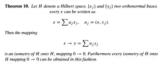

norm induced by inner product is strictly subadditive.
By mazur-ulam theorem every surjective isometry of hilbert space is composition of a transfer and a linear function. So every surjective isometry of hilbert spaces are determined.
Source: Functional Analysis of Peter.Lax page 47 for theorem 9 and page 61 for theorem 10

  • @JonasMeyer: you are right, but theorem 10 above says it is surjective automatically. – Fin8ish Aug 07 '14 at 21:12
  • masoud: No, theorem 10 says that every linear isometry is obtained in this way if it is assumed to be surjective. I already posted an explicit example in the second comment above showing that linear isometries need not be surjective. – Jonas Meyer Aug 07 '14 at 21:14
  • @JonasMeyer: oh sry , I was in a bad mistake. – Fin8ish Aug 07 '14 at 21:16
  • What is the source of the images you have posted here? – Jonas Meyer Aug 07 '14 at 21:36
    @Jonas Meyer: Functional Analysis of Peter.Lax page 47 for theorem 9 and page 61 for theorem 10. – Fin8ish Aug 07 '14 at 21:39
