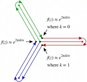

Here is another contour integration using the contour that arises from not using any substitution.
Using the diagram and contour below, where $f(z)=\frac1{(1-z^n)^{1/n}}$
$\hspace{4cm}$enter image description here
it is easy to see that the integral along the red contour is $$ \begin{align} &\int_0^1\frac{\mathrm{d}t}{(1-t^n)^{1/n}}-e^{2\pi i/n}\int_0^1\frac{\mathrm{d}t}{(1-t^n)^{1/n}}\\ &=\left(1-e^{2\pi i/n}\right)\int_0^1\frac{\mathrm{d}t}{(1-t^n)^{1/n}}\tag{1} \end{align} $$ The integrand along each successive arm clockwise is $e^{2\pi i/n}$ times the integrand from the previous arm. $\mathrm{d}z$ along each successive arm is $e^{-2\pi i/n}$ times $\mathrm{d}z$ from the previous arm. Therefore, the integral along each successive arm is the same as the integral from the previous arm. Thus, the total of the integral along all the arms is $$ n\left(1-e^{2\pi i/n}\right)\int_0^1\frac{\mathrm{d}t}{(1-t^n)^{1/n}}\tag{2} $$ Now, if $z$ follows a circle of radius $R$ as $R\to\infty$, $f(z)\sim\frac{e^{\pi i/n}}z$ so the integral along a large clockwise circle is $$ -2\pi ie^{\pi i/n}\tag{3} $$ Since $(2)$ is equal to $(3)$, we have $$ \begin{align} \int_0^1\frac{\mathrm{d}t}{(1-t^n)^{1/n}} &=\frac{-2\pi ie^{\pi i/n}}{n\left(1-e^{2\pi i/n}\right)}\\ &=\frac\pi{n\sin(\pi/n)}\tag{4} \end{align} $$

  • Nicely done. +1 Working backwards, I knew that the integral along each successive had to be the same as the previous arm. But I was having trouble seeing that. – Random Variable Aug 02 '14 at 15:18
  • Consider $1-z^n$ near $z=1$. This looks like $1-((z-1)+1)^n\sim-n(z-1)+O(z-1)^2$. Thus, $\frac1{(1-z^n)^{1/n}}$ looks like $\frac{c}{(z-1)^{1/n}}$. Thus, going around a small clockwise circle centered at $1$ multiplies $f(z)$ by $e^{2\pi i/n}$. Therefore, going from the top to the bottom of $[0,1]$ multiplies $f(z)$ by $e^{2\pi i/n}$. – robjohn Aug 02 '14 at 16:53
  • Since $f(z)$ near $z=0$ is near $e^{2\pi ik/n}$ for some $k$, $f(z)$ is the same on the inside of both arms bordering a given sector. All we need to know about the behavior of $f(z)$ near the arms is determined by looking near $0$ or $e^{2\pi ik/n}$. – robjohn Aug 02 '14 at 16:56
  • This is exactly the kind of answer I was looking for when I asked the question, well done and thank you very much! – Luke Skywalker Aug 03 '14 at 02:02
    How do you know that you could define a branch of $f$ on the region you specified? It's still not clear why a continuous branch must exist outside of those cuts you made. – Mark Aug 03 '14 at 02:28
  • One way to avoid the problem of defining $f$ is not mentioning it. I agree with Mark. Moreover, while this answers the expectations of the OP, it doesn't work for non integral $n$'s. – Omran Kouba Aug 03 '14 at 04:15
  • @Mark: I have added a justification for the branch cut used. – robjohn Aug 03 '14 at 06:05
  • @OmranKouba: the question does specify natural $n\gt1$. – robjohn Aug 03 '14 at 06:21
  • @robjohn, Exactly, that is what I meant, this is an unnecessary restriction, for which the method works. You also need to verify that your definition of $f$ coincides with what we expect for $t\in[0,1)$ and to say what happens if the path of integration encircles all the exceptional points. – Omran Kouba Aug 03 '14 at 16:15
    @OmranKouba: Certainly, your answer and my first answer address general $n\gt1$. However, from Mark's comments, he is interested in a contour integration that uses the $n^\text{th}$ roots of unity. As for the definition of $f$, on any connected domain where $f(z)=(1-z^n)^{-1/n}$ is well defined, there are exactly $n$ possibilities for $f$; each differing by a factor of $e^{2\pi ik/n}$ from the others. All we need verify is the value at one point. That point for my definition is $z=2$. – robjohn Aug 04 '14 at 10:28
  • @robjohn, Connectedness is not sufficient, you need simple connectedness, and your domain is not simply connected. Apply your reasoning to the example of $z\mapsto\log z$ on $\mathbb{C}^*$. – Omran Kouba Aug 04 '14 at 13:45
  • @OmranKouba: I see that perhaps you are worried about the integral that leads to $g(z)$. I have improved the justification of the branch cut regarding circling the whole of the part about the origin. – robjohn Aug 04 '14 at 14:23
  • @OmranKouba $\widehat{\mathbb{C}} \setminus \bigcup\limits_{k=0}^{n-1} e^{2\pi ik/n}\cdot[0,1]$ is simply connected. $\infty$ is not a branch point since $\frac{1}{1-z^n}$ has a zero of order $n$ there. – Daniel Fischer Aug 04 '14 at 16:41
    @DanielFischer, What I meant to say, is that all these comments and explanations, should have been part of the solution in order to make it complete. – Omran Kouba Aug 05 '14 at 05:28
  • @OmranKouba: I've added a section on the branch cut and improved it. Is there something else I should add to the answer? I don't really want it to be a tutorial on contour integration. – robjohn Aug 05 '14 at 06:45
  • @robjohn, being a professor, I always look for points that need extra explanations, or justification. Note that Daniel has a different justification for the definition of $g$, just saying that we need to be careful at some point is good enough. – Omran Kouba Aug 05 '14 at 06:54
  • @OmranKouba Thank you for raising the issue that the branch cut should be explained/justified carefully. I believe this has helped to complete the argument appropriately; thanks for those edits robjohn. Indeed, when posting the question, one of my main concerns was how to define the branch; I think it is more clear now. – Luke Skywalker Aug 05 '14 at 07:22
  • Someone unupvoted. Is there a problem? – robjohn Aug 06 '14 at 00:43
  • @DanielFischer: we could also consider $\frac{z^n}{1-z^n}$ which has no zeros outside of the contour (not even at $\infty$). We can take that to any power, not only $1/n$. – robjohn Aug 06 '14 at 00:47
