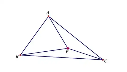

Consider a triangle $\Delta ABC$ with altitudes $h_{a}$, $h_{b}$ and $h_{c}$, where $AB=c$, $BC=a$ and $AC=b$. Show that for any $P$
$$\sqrt{PA+PB}+\sqrt{PB+PC}+\sqrt{PA+PC}\ge 2\sqrt{h_{a}+h_{b}+h_{c}}$$
My try: the inequality is equivalent to
$$(PA+PB+PC)+\sum_{cyc}\sqrt{(PA+PB)(PB+PC)}\ge 2(h_{a}+h_{b}+h_{c})$$

  • To confirm: $h_a$, $h_b$, and $h_c$ are the altitudes in $\triangle ABC$, and are not altitudes from $P$ in the subtriangles? – Peter Woolfitt Aug 01 '14 at 06:08
  • @PeterWoolfitt,Yes,Thank you – math110 Aug 02 '14 at 03:01

  • Things one can assume without loss of generality:
    \begin{align} A&=(0,0)\ B&=(1,0)\ C&=(x,y)\text{ with $y>0$}\ P&=(p,q) \text{ lies in $\triangle ABC$} \end{align}
    The last one in particular implies $0\leq q \leq y$ and $py-qx\geq 0$.
    It's possible to reduce the statement inequality to a polynomial inequality in $PA,PB,PC, h_a,h_b$ and $h_c$, but it's a rather involved expression and I'm not sure it's of much use.
    – Fimpellizzeri Jun 05 '17 at 01:51
I noticed that the LHS is dependent on $P$ but the RHS isn't. So why not try the following approach: Find out the $P$ for which the LHS is minimum , and prove the inequality. Then we are done!
For any given triangle $ABC$, the minimum value of LHS will occur if the $P$ is the Circumcentre. i.e. $PA=PB=PC=R\ (circumradius)$. The inequality reduces to
$$ 9R\ge 2(h_a+h_b+h_c)$$ Now we know $R,h_a,h_b,h_c$ in terms of the sides and angles. Can you proceed from here?
