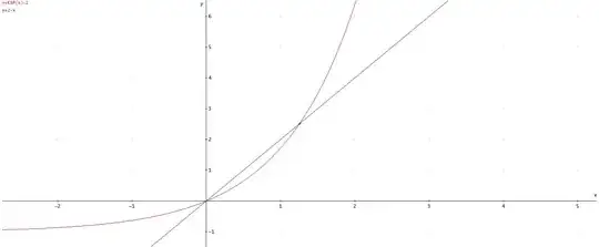

Using graphic inspection, we have that
We can observe that there are two solutions: $x=0$ and,approximately, $x=1.25643...$
