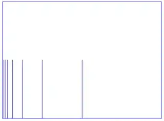

Another example is given by conformal map $G$ onto this rectangle with infinitely many slits:
rectangle with cuts
Here the real part of $G$ is continuous up to the boundary, but the imaginary part is discontinuous, despite being bounded. (There is a point of unit circle where its cluster set is an interval of the size equal to the height of these slits.)
