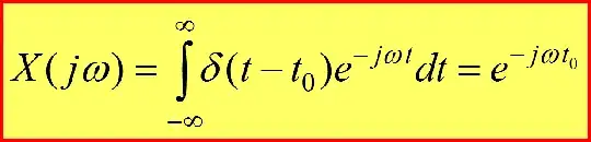

let us consider following integral
according to property of delta function,we can write this intgeral as
$\int^{t=\infty}_{t=t_0} e^{-j*\omega*t}$
or we can write as
$e^{-j*\omega*t}/(-\omega*t)$ from $t=t_0$ to $t=\infty$,if we calculate it we get
$\frac{e^{-j*w*t_0}} {w*j}$
but i did not understand why is not given in formula denominator part?thanks in advance
    I think there has been an abuse of the delta integral here..I think the answer should involve explaining why $\int_{-\infty}^{\infty}\delta(t-t_0)f(t)dt = f(t_0)$. Which would be nice to see :). So in around about why you have asked an interesting question! +1! But this is just my opinion. – Chinny84 Jul 08 '14 at 11:23

In less technical language: The delta “function” has the defining property that $$\int_{-\infty}^\infty \delta(x)f(x)\,dt=f(0)$$ for any continuous function $f$. Substituting in $x=t-t_0$ with $f(x)=e^{-j\omega x}$ immediately yields the desired result.
Your rewrite of the integral “according to property of delta function” is not according to any property of the delta known to me.

  • That was the answer I was going to put but is it out of the scope of this particular question to why this integral holds? I do not want to overload/monkey patch on another question if it is not necessary :). – Chinny84 Jul 08 '14 at 12:15
  • @Chinny84 I was puzzled about your reluctance to post an answer. Not sure what you mean by “out of scope”. I would have liked to link to an answer that is more directed at the OP's level, but a quick search did not reveal such an answer. (Perhaps I gave up too easily.) … Oh, just saw your followup comment. As you say, never mind … – Harald Hanche-Olsen Jul 08 '14 at 12:26
  • I think it was a miscommunication. I wasn't to sure if the answer needed to explain why the integral with the delta function holds. But having a look at the link you provided it seems it would be too technical. Don't worry, I think I am just over analysing the question :). Great answer :). – Chinny84 Jul 08 '14 at 12:42
