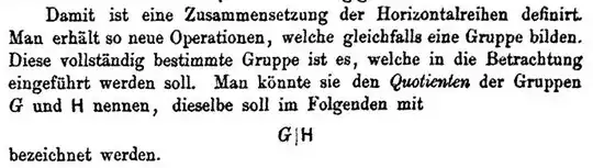

Update: skimming Hölder's article confirms Young's claim: Holder uses the terminology "Quotienten der Gruppen", see the following excerpt from p.31

    Skimming the paper, Hölder uses the term "Faktorgruppe" (factor group), and refers to an expression "factor of composition" that he attributes to Jordan. – Johannes Kloos Jul 06 '14 at 01:35
  • @Johannes He also uses "Quotienten der Gruppen* - see my update. – Bill Dubuque Jul 06 '14 at 02:23
    "This way, a new composition of the horizontal series is defined. We obtain new operations, which also form a group. It is this fully determined group which shall be taken into consideration. One might call it the quotient of the groups $G$ and $H$, and it shall be denoted $$ G|H$$ from now on." – Hagen von Eitzen Jul 06 '14 at 11:21
