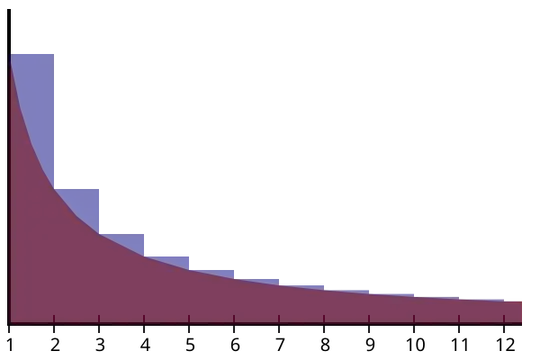

The best thing is to just plot the graphic of both functions, and to interpret it. Notice how the first blue area on the left is smaller than $1-\dfrac12$, the second is smaller than $\dfrac12-\dfrac13$, the third is smaller than $\dfrac13-\dfrac14$, etc. At the same time, all these quantities are positive, meaning that the series is strictly increasing. But it is also bounded by $1$, since $\bigg(1-\dfrac12\bigg)+\bigg(\dfrac12-\dfrac13\bigg)+\bigg(\dfrac13-\dfrac14\bigg)+\ldots$ is telescopic in nature. And since it is both bounded and monotonous, it follows that it converges.
The two functions are $f(x)=\dfrac1x$ and $g(x)=\dfrac1{[x]}$ . The area of the former yields the natural logarithm, and that of the latter, the n-th harmonic number. – Lucian Jul 05 '14 at 23:16
