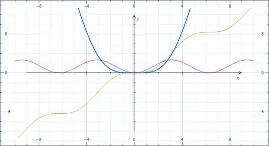

From $\cos^2x+\sin^2x=1^*$, we have $|\cos x|\le1$, and $$\color{magenta}{f''(x)}=1-\cos(x)\ge0.$$ The zeroes of $f''$ are isolated, at $x=2k\pi$.
This implies that $\color{green}{f'(x)}=x-\sin(x)$ is strictly monotone increasing, for all $x$, except at $x=2k\pi$. As $f'(0)=0$, this is the only real root of $f'$.
This implies that $\color{blue}{f(x)}$ is strictly decreasing for $x<0$ and strictly increasing for $x>0$. The global minimum of $f$ is $f(0)=0$, and $$\cos x-1+\frac{x^2}2\ge0.$$
