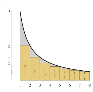

For each integer $m \ge 2$, we have $\dfrac{1}{m} = \displaystyle\int_{m-1}^{m}\dfrac{1}{m}\,dx \le \int_{m-1}^{m}\dfrac{1}{x}\,dx$.
Sum this up from $m = 2$ to $m = n$ to get $\displaystyle\sum_{m = 2}^{n}\dfrac{1}{m} \le \sum_{m = 2}^{n}\int_{m-1}^{m}\dfrac{1}{x}\,dx = \int_{1}^{n}\dfrac{1}{x}\,dx = \ln n$.
Then, add $1$ to both sides to get $s_n = \displaystyle\sum_{m = 1}^{n}\dfrac{1}{m} \le 1+\ln n$.
EDIT: Here is a good picture to go with this proof.
Source:http://mathfactor.uark.edu/images/harmonic2.jpg
