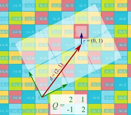

As an example, I try to show how these things relate in the following image:
Division
$$(3, 5) = (2, 1)\begin{pmatrix}2 &1 \\ -1 &2\end{pmatrix} + (0, 1)$$

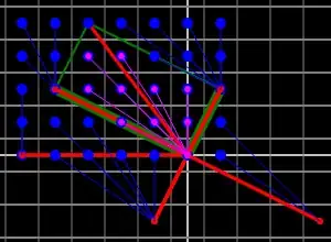

Let's look at some pictures to see if this seems like it's working properly. We can do calculations per above, then draw the resulting $\vec{d}Q$s and $\vec{r}$s using python3 and easygraphics.
First let's replicate the original question picture using this algorithm. $\vec{u}$ and $\vec{v}$ are big green, with u+v extended by small green lines, to show the extent of the parallelogram formed by u and v. $\vec{d}Q$ is red, $\vec{r}$ is blue, and $\vec{n}$ is yellow.
showing vectors, u is 2,1 and v is -1,2 showing d as 3,4 and r as 0,1, and n as 3,5
Now let us replicate this but we will try sixteen different values for $\vec{n}$, in a grid from 1,1 to 4,4. $\vec{n}$s are omitted for clarity. This seems to be matching the grid patterns in the original question:
ds and rs for u 2,1 and v -1,2
If we gather all the values of $\vec{r}$s calculated here, we get $P$, and we can also draw it's values:
showing P for u 2,1 v -1,2
These are all inside the parallelogram formed by $\vec{u}$ and $\vec{v}$ and match the original picture.

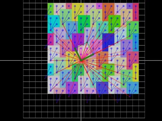

The next image is the same but with $\vec{u} = (-4,2)$ and $\vec{v} = (1,2)$ and $\vec{n}$ ranging from x = -5 to 1 and y = 0 to 5. The Ps have been drawn in Magenta on top of the r's, and d's.
vectors when u is -4,2 v is 1,2 and n ranges from -1,-5 to 1,5 on a grid

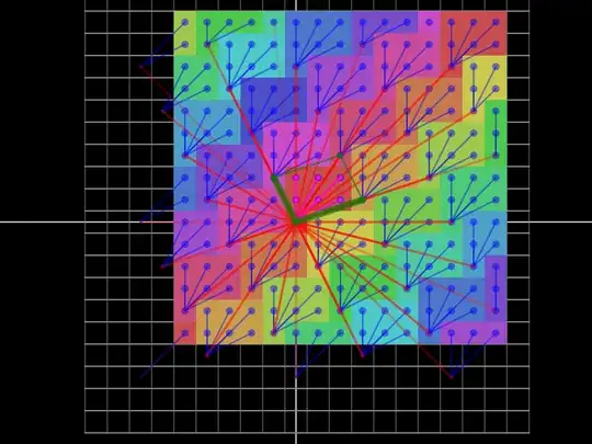

Now, does it work for "non square" or "not right angle" choices of u and v? (where $\vec{u}$ is not orthogonal to $\vec{v}$). This picture seems to show that it works reasonably well.
non-right-angle (orthogonal) vectors u and v showing valid results for ds, rs, and P

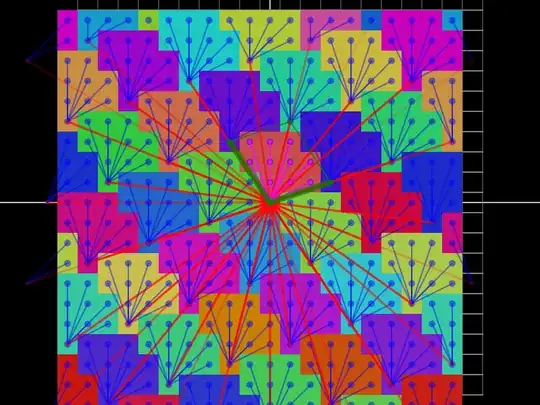

It even seems to work pretty well for $\vec{u}$ and $\vec{v}$ in the third quadrant, when all xs and ys are negative.
picture showing results of computing ds and rs for u and v both in the 3rd quadrant with negative xs and ys

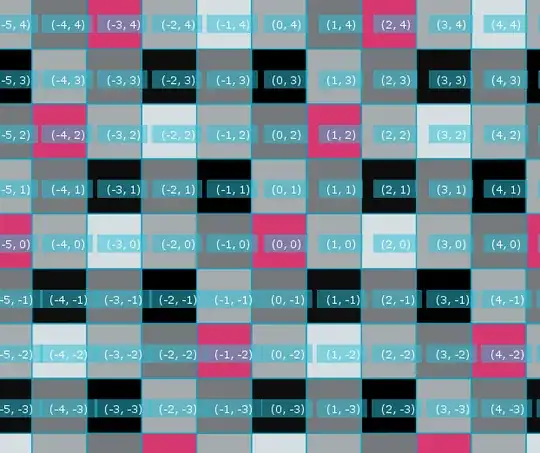

Tiling of the plane
Turns out these also create tilings of the plane, using a sort of pixellated parallelogram.
With each $\vec{r}$ given it's own color, we get a picture kind of like the first picture in the question
Tiling with each R a different color

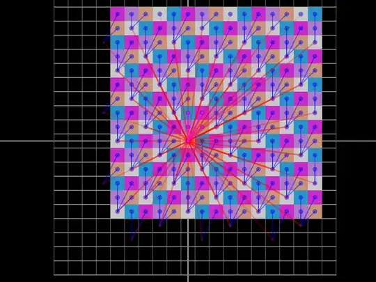

If we make the coloring based on $\vec{d}Q$ we get a covering of Polyominoes
Polyominoes tiling of plane
