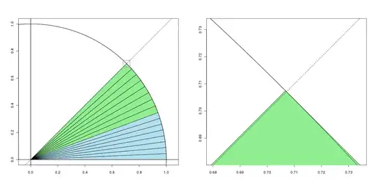

Our solution is formed by constructing 16 adjacent (nonoverlapping) right triangles. Eight of these triangles have area $\sqrt{2}/64$ each and the other eight triangles are of area $\sqrt{3}/64$. The construction is done in such a way that, collectively, they are larger than 1/8 of a unit circle.
Below is the final picture followed by a discussion.
Final result
Final construction
The triangles in blue are each of area $\sqrt{2}/64$ and each green one has area $\sqrt{3}/64$. The dotted line is the forty-five degree line, so that the portion of the circle between it and the $x$-axis is one-eighth of the whole and so has area $\pi/8$.
The right panel is a zoomed in version of the left panel. The small grey square on the forty-five degree in the left panel shows the "zoom" box that corresponds to the entire figure in the right panel.

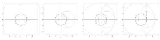

Constructing tangent lines of length $\sqrt{2}$ and $\sqrt{3}$
To construct the necessary triangles, we need to be able to construct tangent lines to the unit circle of length $\sqrt{2}$ and $\sqrt{3}$, respectively.
Below is one such construction of a line segment of length $\sqrt{2}$. enter image description here

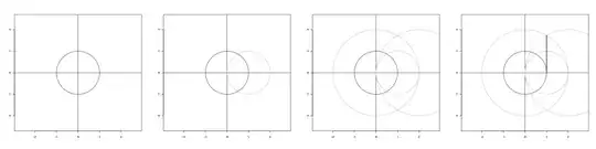

Here is a construction of a line segment of length $\sqrt{3}$.
sqrt(3) construction

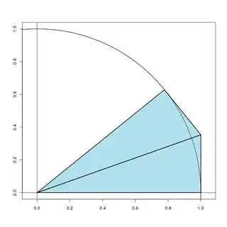

Example construction of paired right triangles
We form the right triangles in reflected pairs so that they always dominate the corresponding segment of the circle. Here is an example of a construction using a side length of $\sqrt{2}/4$ tangent to the unit circle. The two triangles put together obviously have area $\sqrt{2}/4$ in this example.
Triangle pairs: Total area is sqrt(2)/4
