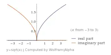

Therefor, for the purposes of convention, a square root has been defined to be the absolute value of the original number that was squared. This why, if you plug the functions $y^2 = x$ and $y = \sqrt{x}$ into a graphing calculator or Wolfram Alpha, you will find that you get two very different looking graphs. Notice how the the graph of $y=\sqrt{x}$ never goes below the $x$-axis. Had a square root been defined as always negative, the graph of $y=\sqrt{x}$ would simply be flipped about the $x$-axis.
Technically this statement is wrong. He could say, "The square root of a positive number is positive (by definition)". E.g. for 0 you get $\sqrt{0}=0$ which is neither positive nor negative. And for negative numbers you even get complex solutions which are neither positive nor negative nor 0.
