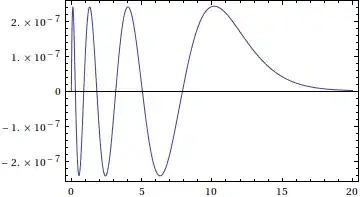

Here's a plot of $R(x)-\exp(-x)$:
plot of R(x)-\exp(-x)
Hastings's book gives other, simpler approximations you can use if you have less stringent accuracy requirements. You can now plug this into your $\chi^2$ PDF expression to get the approximation you need.
